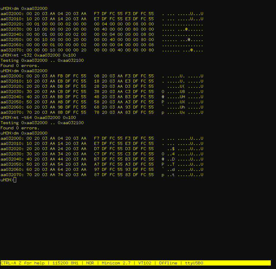

Ok, so I just tested the DDR3 memory with the "mt" command, and it
seems to be working properly. I have attached two screenshots using
"mt".
Haven't really looked into "mt" in much detail just yet, but the
second "mt" test shown attached is interesting. After a few
iterations of the command, it looks like I have to run "mt' over the
memory space I am testing first, in order to get the values
complemented after subsequent invocations of "mt" with the -t option.
Please let me know if I am missing something. Otherwise I will now
continue on in moving the DDR3 initialization to rom_reset.S.
Thanks.
