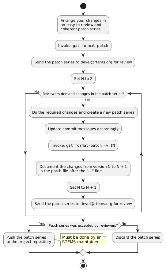

If you want to review the figure it is ...
http://www.plantuml.com/plantuml/png/dP0_ZzDC4CRx_HGZwoqIlSf9K8Q28451ST7f3WgaD7lsutZ1EsjcnuxoxLcFWt9790gAbNR-_6QUUNPPlUWOU-VivzpsWuZd8-YSHg6wc_-P0X_OCy7dCsaYmHHm8i_DWUlKGS1AWzUwemm9oE_AeCyyfH_OKbKTWrAR97hTM5DLpVKdS4FQuHKuJsymeT-98kQx9CSPlMnSCANztFQsHASkzA3LerKXkR2ng7gX-sR3-pM5JAjlo6j7jFsOh4FmSmo2AsbJ15v1dXYdFyyhwDUXcSjrYZ4eHUJiZQph94tWOt-slhyOGPk9_jkR7IQb7YDOJT1l7QsaI1CaXyJBtNlwdzuS-DLfxMo3RnLYoMgpsLJK1uPDDi-khEN-pVx2N2pVfxLpeQNLmqlyvEr-38g6diyN3b9SdtVnrVU7CNStwm-iQKbA-evQIJ2a73J9OYKd1KauTbe2elinAps3ciIOjtcszEENJ_TF57rWBGzoLxBWncY7FY_gpV6GQo-tDjYXeNKkQngSsvLeZFql

This step is not in the figure.
Built against which BSPs?
> +* The patch does not introduce new test failures in existing tests.
Again which BSPs? This assumes expected fails are valid for the bsps being tested.
What about tickets and the "Closes ...", "Updates ..." etc tags?
