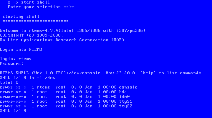

Hi,
I have attached a diff to 4.9 which will make the pc386 install
tty_drv.h. There is also a diff to the fileio sample to show
the configuration changes. Plus a png to show that the
serial devices are there.
Hopefully this will help.
--joel
